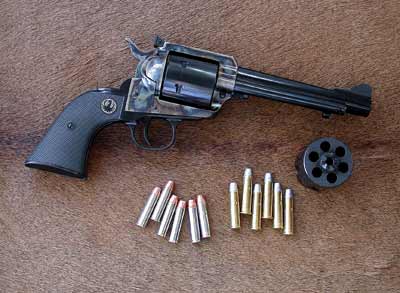

Years ago Hamilton did a beautiful .32-20 on a Ruger Old Model .357 Blackawk. In this case he removed the adjustable sights, welded and re-contoured the top strap to come up with an easy handling sixgun which basically looked and felt like a Colt Single Action. Now Hamilton has the Ruger 50th Anniversary New Model .357 Blackhawk to use as a platform for custom sixguns. The first gun up is one of these with two cylinders, one in the always useful and desired .32-20 and the other in perhaps the even better .327 Federal Magnum.
The 50th Anniversary Ruger .357 is the same size as the original Ruger .357 Blackhawk, has the same Colt Single Action-sized XR3 grip frame, and, unlike the original, is all steel. It is the perfect platform for building a .44 Special or .45 Colt, or even a five-shot .44 Magnum all of which Hamilton has done, however this time he has gone smallbore. To easily distinguish between the two chamberings the .32-20 is fluted while the .327 cylinder is not, and both are expertly fitted to the frame which has a 5-1/2” Douglas barrel. The front sight is a tapered post on a ramp and is matched up with one of Hamilton's heavy-duty field rear sights. The hammer and frame are case colored by Turnbull, a locking large knurled head base pin is fitted, the action is tightened and tuned, and the trigger pull set at 2-1/2 pounds. At 46 ounces this is a relatively heavy sixgun which makes it even more pleasant when shooting either cartridge. Since this is basically a .327 project I mainly concentrated my shooting with the .327 Federal. I did run two factory .32-20 loads both in the 800+ feet per second range from Black Hills and Winchester and they shot as easily and accurately as a .22.

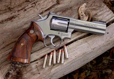

Hamilton’s double action .327 Federal Magnum is built on a medium-framed Smith & Wesson with the result being a most aesthetically pleasing, and superbly shooting double action sixgun.  This conversion starts with a stainless steel .357 Magnum Model 66. For the barrel Hamilton uses a stainless steel four-inch Model 617 .22 barrel which is re-bored and marked “.327 FED. MAG. CTG.”  on the right side of the barrel. The full under-lug is maintained on this barrel and it is fitted to a Model 66 frame which then receives a Model 617 cylinder chambered to .327 Federal Magnum. The action is tightened and tuned, the single action trigger pull set at 3 pounds, and an undercut front post of the proper height fitted to the ramp on the Model 617 barrel.
The Model 66 is the stainless steel version of the .357 Combat Magnum which became the Model 19 in 1958.  The Combat Magnum came with K-framed diamond checkered stocks which are extremely difficult to find today and if they are found demand very high prices. To finish off this package Hamilton used a pair of exquisite “diamond” Smith & Wesson Target stocks which are in fact perfect recreations of original S&W .357 Combat Magnum stocks carried out in fancy walnut by stock maker Keith Brown who not only duplicates early Smith & Wesson Target and Magna stocks but classic Roper and Kearsarge pre-War stocks as well. This certainly must be one of the most exquisite double action smallbore sixgun in existence.

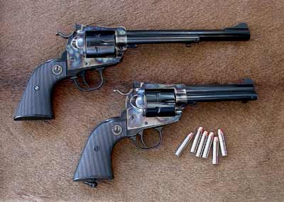

The final two in this .327 Quartet is a pair of custom Single-Sixes. Hamilton starts with the New Model Ruger Single-Six chambered in .32 Magnum. Hamilton considers this the natural home for the .327 in a single-action as the original cylinder diameter is adequate for six-shots and only has to be replaced by one which is longer to accept the .327 cartridge. The new cylinder fills out the cylinder window without any modification to the frame.

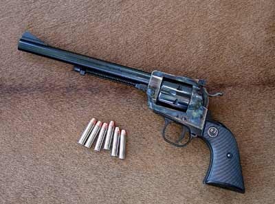

          The two .327 Single-Sixes are basically the same except for the barrels. First comes the long barreled version at 7-1/2”; for me single actions balance the best and are the easiest to shoot with this barrel length.
 A new cylinder chambered in .327 is line-bored, fluted, and black powder chamfered. The action is totally tuned, trigger pull set at just a hair over 3 pounds, Bisley hammer and frame color cased by Turnbull, steel ejector rod housing installed, oversized locking base pin fitted, and a BCA heavy-duty rear field sight matched up with a serrated front ramp sight.  The second .327 Single-Six has a barrel which started life as Smith & Wesson ribbed K22 barrel. Hamilton machined off the underlug, re-bored it to .327, cut it to proper length of 4-5/8”, and installed it along with a steel ejector rod housing.
The ribbed barrel matches up beautifully with the Single-Six frame.  A Bisley hammer is installed, the front sight is an undercut post, and the frame and hammer are also case colored by Turnbull. Hamilton not only likes smallbore cartridges he also is a promoter of lanyard rings one of which has been the installed on this little sixgun. A lanyard ring properly used can prevent the damage or even the loss of a beautiful sixgun while traveling by horseback, boat, or simply hiking in rough country.
