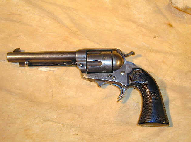

Starting material was a Colt's Bisley Model revolver circa 1902, in my favorite chambering: 38WCF. The gun was a no-finish gun with a damaged (read “FITZ” job) trigger guard, and a worn down cylinder bushing which caused a lot of end play in the cylinder but was easily remedied. I bought it for a fair price, figuring to rebuild it as a shooter, or part it out and use the frame to rebuild a 38-40 Bisley that blew up in my hands a couple of years ago and had lost it's topstrap and cylinder.
select an image for a larger view
Before
After
Initially all I did was to tighten up the cylinder play, and fit a new hand to correct a timing issue. I replaced the trigger guard with another Bisley TG from the parts box and was off to the races. The gun shot pretty well but printed a bit high, so I welded up the top of the front sight blade to make it taller and dressed it down to the proper height a few rounds and a few file strokes at a time. It then shot point of aim with my standard load. It seemed that this gun might be the basic platform to build my #5 SAA. Since it already had quite a few parts that were not part of this gun when it left the factory, and had basically no original finish remaining, it’s collector value was not great and it seemed like a good candidate for a remodel of this type.

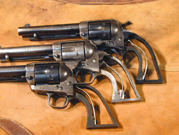

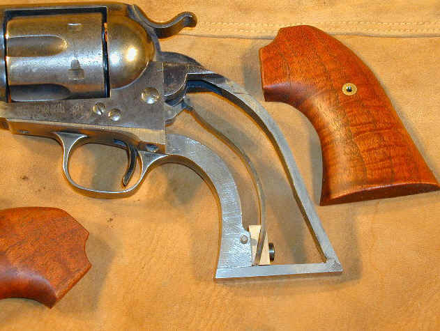

Stage one was the grip modifications. This was basically a cut and bend on the backstrap, and the fabrication of a new bottom strap. This was all accomplished with a hacksaw, file, drill press, and a belt grinder. I adjusted the shape of the backstrap slightly from the original design to give me the best sight alignment with MY grip. If I close my eyes and point the gun, when I open them the sights are in perfect vertical alignment. This may be the true beauty of a custom gripframe. It also speaks wonderfully for the basic Keith-Croft design.
The metal mods to the grip took about three hours using hand tools a wire feed welder and a belt grinder. These turned out to be the easy part. I knew going in what the basic parts were to do the conversion, but only when I began to assemble the gun did I realize that there were quite a few other problems involved.
First of all was the problem of the mainspring to power this puppy. The Colt Bisley hammer that is employed in this conversion is a true marvel of design. I find it to be the easiest cocking and best looking hammer ever created for a single action sixgun. It is actuated by a curved mainspring which has specialized fingers that mate to a pivoting stirrup which dangles from the bottom of the Bisley hammer. The normal Bisley triggerguard/frontstrap positions and holds this mainspring in a very specific orientation to the hammer stirrup in order to provide proper tension of the mainspring against the hammer.

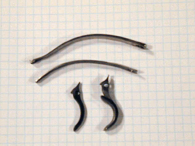

At this point, I thought I had the conversion pretty well knocked out. More was to be revealed. Just as the Bisley hammer is designed to work with a Bisley mainspring, it is also designed to function with a Bisley trigger. The smaller SAA triggerguard used in this project however will not admit a Bisley trigger without major modifications to both the triggerguard and the trigger. In looking at the pictures of Elmer's gun it appears they used a SAA trigger, and so that is the approach I decided to use. The parts went together O.K. and with the backstrap and bolt removed the revolver functioned with the new mainspring and trigger. However when the new backstrap was attached, and the bolt and bolt spring installed, more problems became obvious. Most apparent was the fact that the hammer would not retract far enough to go into full cock. The cylinder was rotating fully and the bolt was locking properly in the cylinder recess, but the cylinder lockup was occurring before the sear tip of the trigger nose could engage the hammers full-cock notch. We had a serious timing problem.
Disassembly of the gun and comparison of the SAA trigger to the original Bisley trigger told the tale. As much as I have tried to become well versed in Colt’s minutiae, I did not realize that the Bisley trigger has a significantly longer nose than does the SAA trigger. The Bisley trigger nose length was .275” vs. .330” for the SAA. I realized some trigger modifications would be necessary as well. Using the Bisley trigger as a guide, I slowly removed material from the nose of the trigger until the nose would engage to the full-cock notch a few thousandths of an inch before the cylinder bolt completely stops the cylinders rotation. This is the absolute max. sear length, and leaves a little metal left for final sear angle and length adjustment in the final trigger job that will follow. A quick case hardening of the nose with Casenit to preserve it’s shape and the lockwork was up and running.

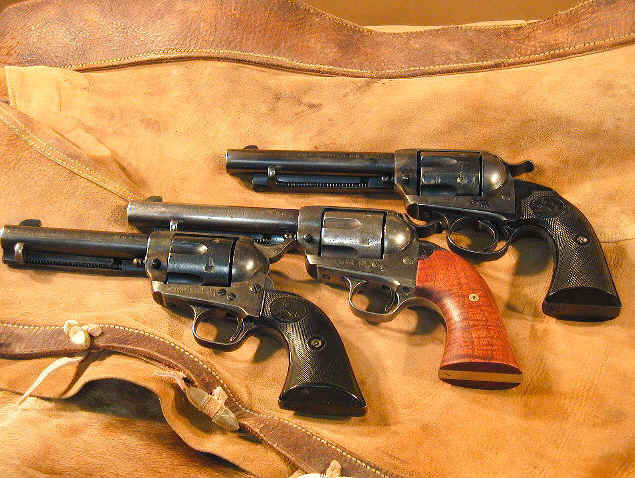

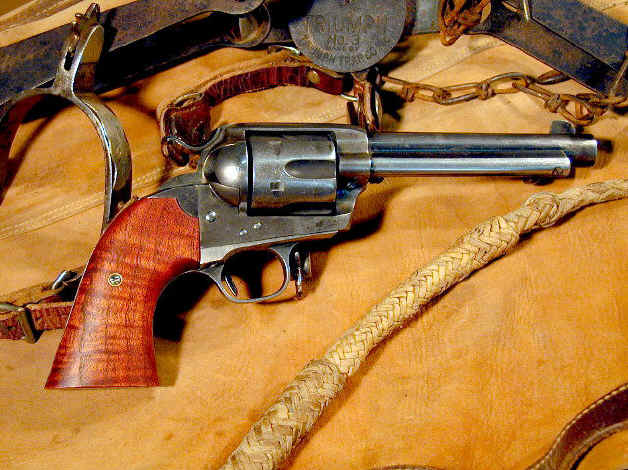

Anyway we now have a functioning sixgun. It points, locks, and drops. It was a good shooter before the mod’s, and I have every expectation that it will continue to be .I have completed a set of grips for it and now that they are finished I will take it out for a preliminary test drive.
select the image for a larger view
I will probably do some other upgrades in the fullness of time including S&W revolver sights and perhaps a quality case and blue restoration, engraving, who knows? But first I’m gonna shoot it.
