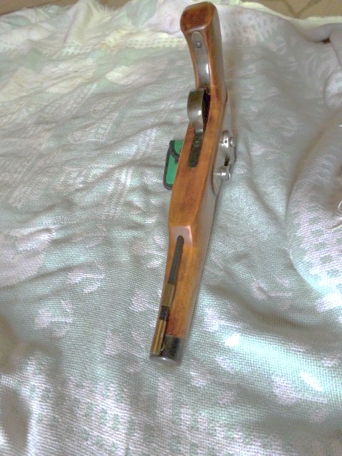

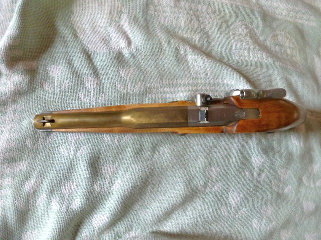

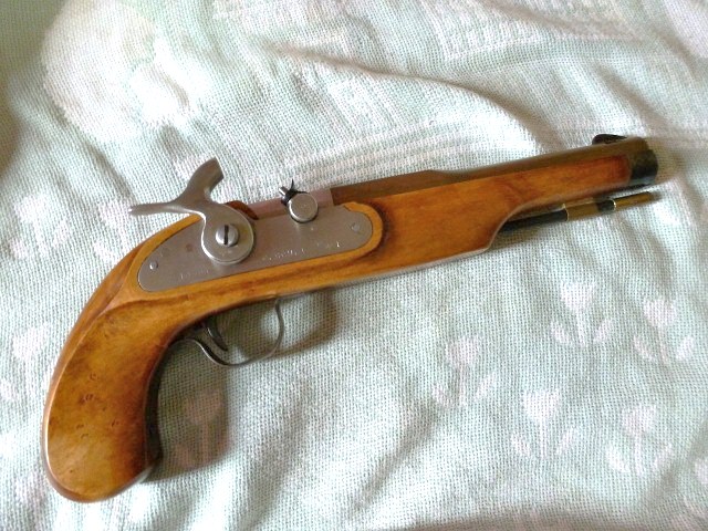

     When I got out of the service and started going to college I found that I needed a job to help get through those tough times. I asked a friend who owned a machine shop if I could work for him and he took me on as a kind of gopher and trainee. He taught me the basics of machine work and then put me to work where I slowly gained some knowledge of the profession.
     After I had worked for a few years I got hooked on the idea of making a blackpowder pistol. I asked my boss if I could buy some of the scrap metal and use the machines to start my project and he countered with a deal I couldn’t refuse. He said I could use the shop anytime after hours and he would give me any of the scrap or even new material if I fulfilled my obligation to finish the project completely as a kind of apprentice project. The following pictures show the pistol that is the end result of that project.
     I started by drawing up a rough plan for the work, barrel, sidelock and parts along with a stock pattern for the wood. The barrel is made of one inch brass hex bar stock, the sideplate and breechplug and all the associated inner workings are of stainless steel. The trigger mechanism and trigger guard are made of cold rolled steel and blued to give the pistol a kind of three tone appearance. The stock is red maple finished with Tru-Oil mixed with a little stain.
     The barrel is .31caliber and rifled with two grooves by a broach I made myself and pressed through the barrel on a 100 ton hydraulic press. The sidelock is a coil spring type which I designed myself. I even turned the screws that hold the sidelock on and threaded them to fit.
     This gun has never actually been fired, I only shot a few caps off to insure everything worked as planned. I treasure this pistol, not so much as a thing to be shot, but as a testament to my perseverance in completing the project and fulfilling my commitment to my boss.  I went on to work in that shop for almost six years and the experience was worth every minute.
